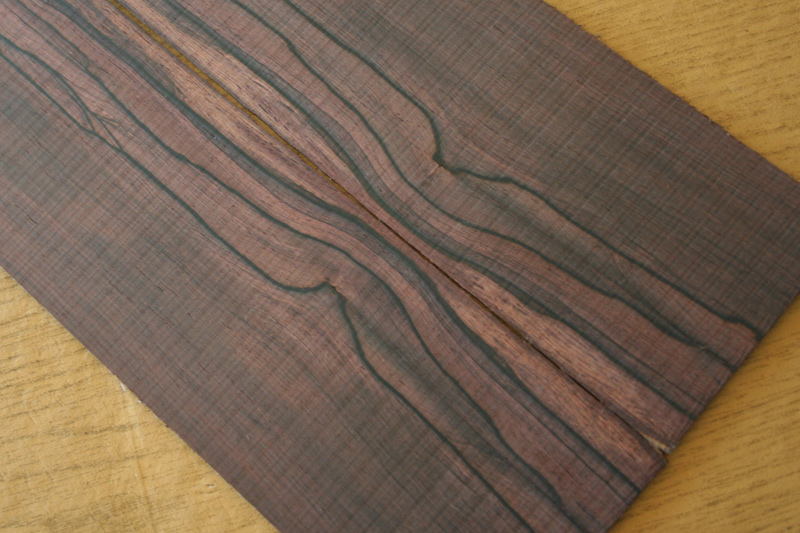

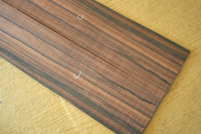

I have a few boards of figured Madagascar Rosewood that unfortunately are too small for a guitar. Its a shame to waste as it has some real nice spider webbing on the backs!
I may be listinging it at the Luthiers Forum for Ukulele sets.
I don't know if they are big enough for ukes or what model of uke it would fit.
The backs are 4" x 15" each and the sides are 20" x 4" each and all about .105 to .110 thick.
Please let me know what you think. The backs are a lot more figured than the sides....
Here are some back pics:

Beautiful wood... it will make a fine Uke. I happen to love Madrose myself. Put an adi top on that!

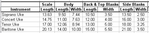

I think that as a set they would be appropiate for a soprano or concert sized uke. The limiting factor is the width of the back pieces. The next size up, tenor, has a body width over 8".

For reference, this is a screen shot of part of a spreadsheet I made to help me sort out tonewood set size requirements for various instruments.

Very beautiful wood!  Looks like a set for a soprano uke.

ideal size for a soprano set. You could probably get $40 per set. A concert
size uke would depend on the makers concert size.
